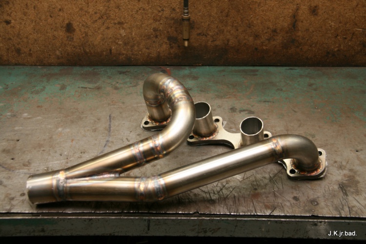

6500  | | 07. Nov 2013, 22:52 |
#9640
|  Kopš: 19. Feb 2007
07 Nov 2013, 13:39:57 genaadijs rakstīja:
sitaa laba...
----------------- www.hgkracing.com | Offline | | |
