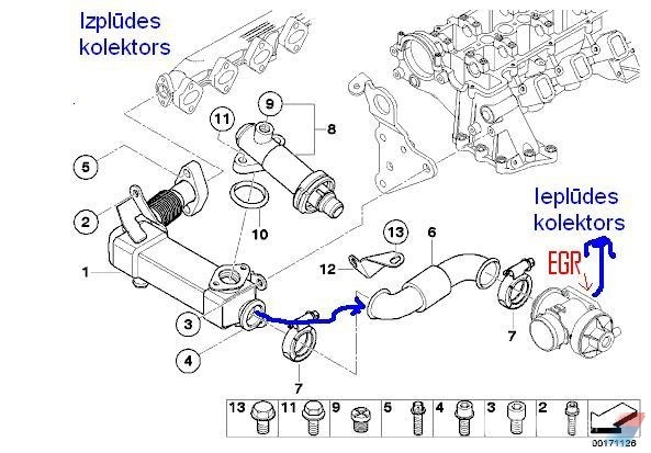

Par EGR teemu runaajot. Kaads ar iztulkot galveno domu?
Not actually completely true, people believe these things because they don't understand how it works, they believe it is there to "lower emissions" without understanding the mechanics behind that.
The sole purpose of the EGR system is to reduce the formation of Oxides of Nitrogen (NOx). These are formed when the temperature in the combustion chamber reaches very high levels. To avoid this situation, the EGR system is used to lower combustion chamber temperatures by admitting small amounts of exhaust gas back into the combustion chamber. As you can imagine, exhaust gas does not burn, and does not help the combustion process. If the EGR system admitted exhaust gas into the combustion chamber at idle, it would cause a rough idle, or stalling. As a result, EGR does not allow exhaust gas into the chamber at idle or at wide open throttle so ultimate power is unaffected.
If you simply remove the EGR system from the car, but do not disable it in the ECU, you can run into significant problems as combustion chamber temperatures can rise to unacceptably high levels. Anyone who thinks that's a smart idea should remove their EGR now and start saving for the possible damaged head and pistons......

05 Oct 2009, 18:12:55 Rifo rakstīja:
Šis teksts gadījumā nav par benzīna dzinēju?
Katrā ziņā es ieteiktu labāk izmazgāt EGR un ieplūdnieku nekā to atvienot, jo ja atmiņa mani neviļ, tad EGR atveras pie brīvgaitas un ļoti maziem apgriezieniem. Tas nozīmē, ka jaudu tev neietekmēs uz lielākiem apgriezieniem, kad ieplūdniekā parādās pozitīvs spiediens.

Runa bija par diizeljiem. Bet landrovera
http://www.landyzone.co.uk/lz/f10/p38-2-5-diese...sible-64542.html
